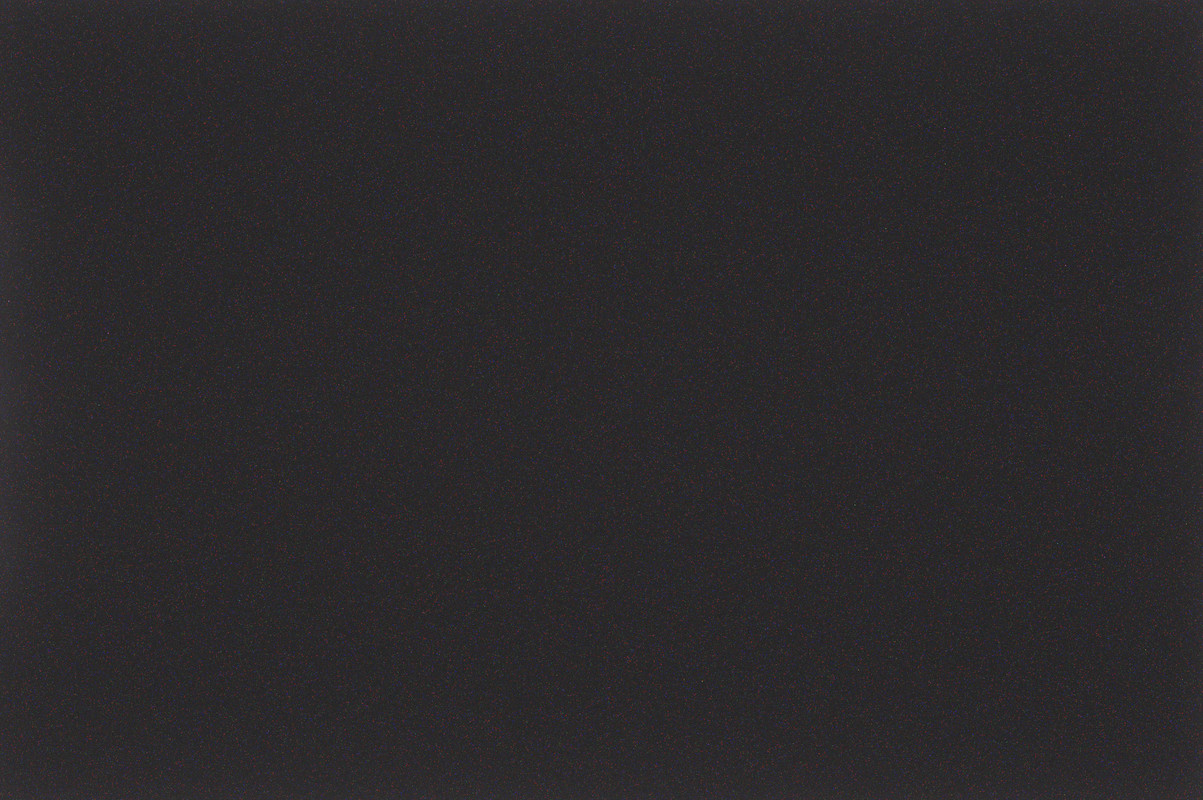

Now let's see a master dark from the D7500 (again, stretched at extreme levels). This is actually from 54x240 second subs, right below the threshold where the D7500 starts perhaps needing darks:
There is simply no comparison. There is almost no dark signal, since the D7500 has in sensor dark current suppression (meaning the main source of thermal signal is "choked" electronically inside the pixel, before any electron gets captured). There is very little amp glow on the left edge which one would probably want to crop anyway, a few hundred hot pixels and that's all. Would I want to add the faint random noise of that image to my lights, just to get rid of the hot pixels? No I wouldn't. Much better to use a BPM or a hot pixel detection algorithm in the raw processor. They will not introduce noise, unlike the dark. And they will produce a more correct result, as they interpolate the value of the hot pixel from the neighboring ones instead of clipping it to zero.
And like I said the D7500 is an exception in that it probably needs darks after some point. It is very different with most other modern DSLRs.
