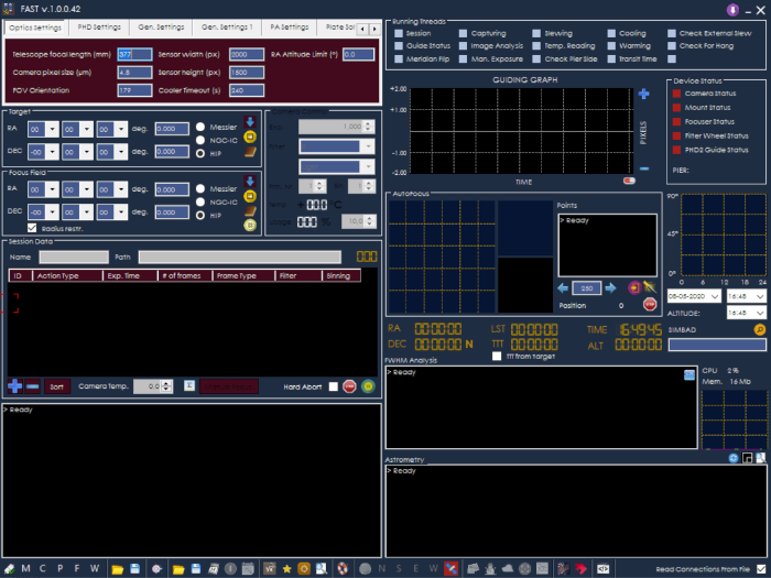

Hi there,Is there a way to know/calculate when I will need to perform the meridian flip without having to check how close my camera is getting to the mount frequently?Or is there a way to not have to meridian flip at all midway through acquisition? Perhaps an extension to the mount?
Thanks!
As someone suggested you can download APT or you can use the software I wrote (FAST) which I'm going to release for FREE in few days, maybe some weeks, and that manages the flip during the session.
Cheers.
Roberto
