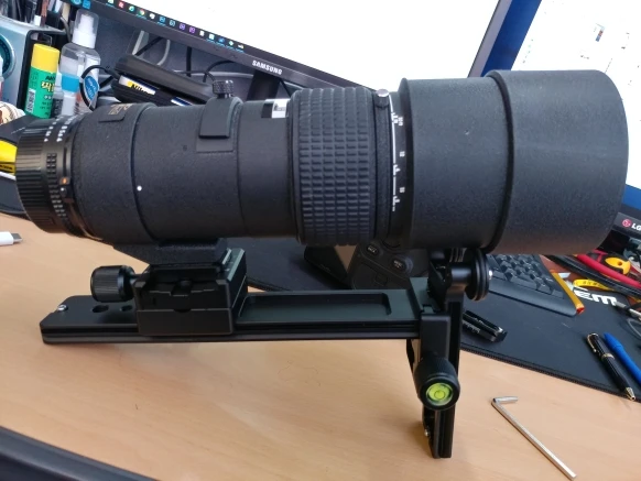

Burak Mehmet Gurbuz avatar
Hi everyone,
Due to logistics problems the 3d printed collar was not a possible choice for me however I bought something else and I believe this item deserves your attention as well.
https://www.aliexpress.com/item/Andoer-L200-Telephoto-Lens-Support-Long-Lens-Holder-Bracket-Compatible-for-Arca-Swiss-Sunwayfoto-RRS-Benro/32823937010.html
This item is an all-round cheap + versatile one.
Kind regards!
