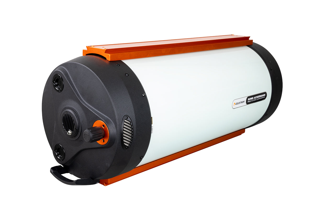

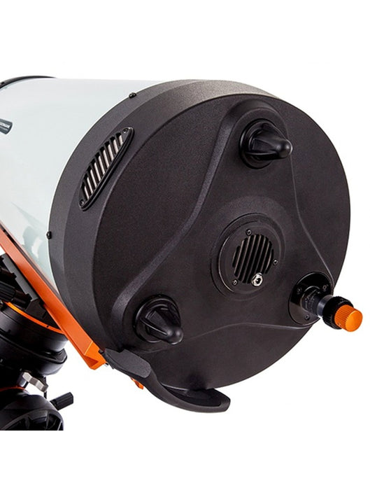

Hi, I’m probably late to the party, but to visually distinguish between the V1 and V2 just look at the back of the OTA:
V1 is equipped with mirror locks & 10:1 Feathertouch focuser
On V2 there are no mirror locks & instead of 10:1 Feathertouch there’s a singlespeed Celestron focus knob
11" Rowe-Ackermann Schmidt Astrograph (RASA 11) V2 Optical Tube Assembly (CGE Dovetail)

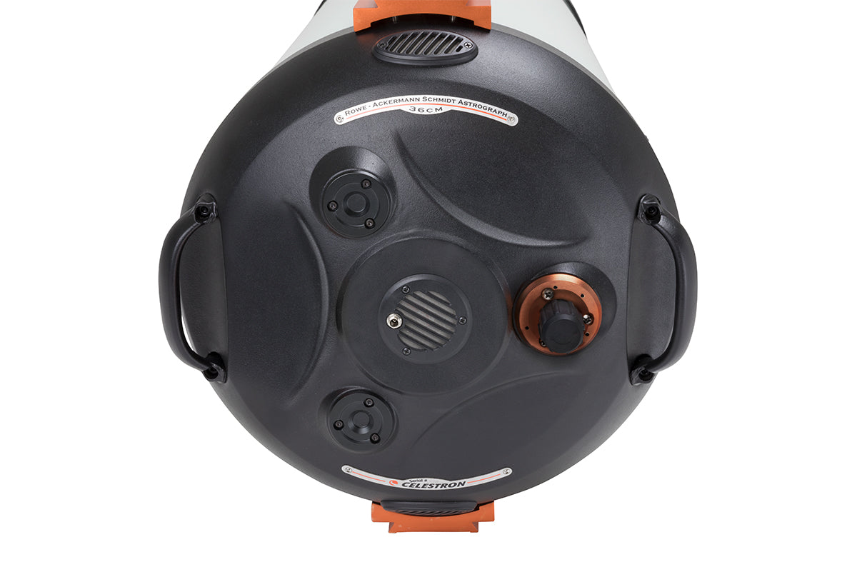

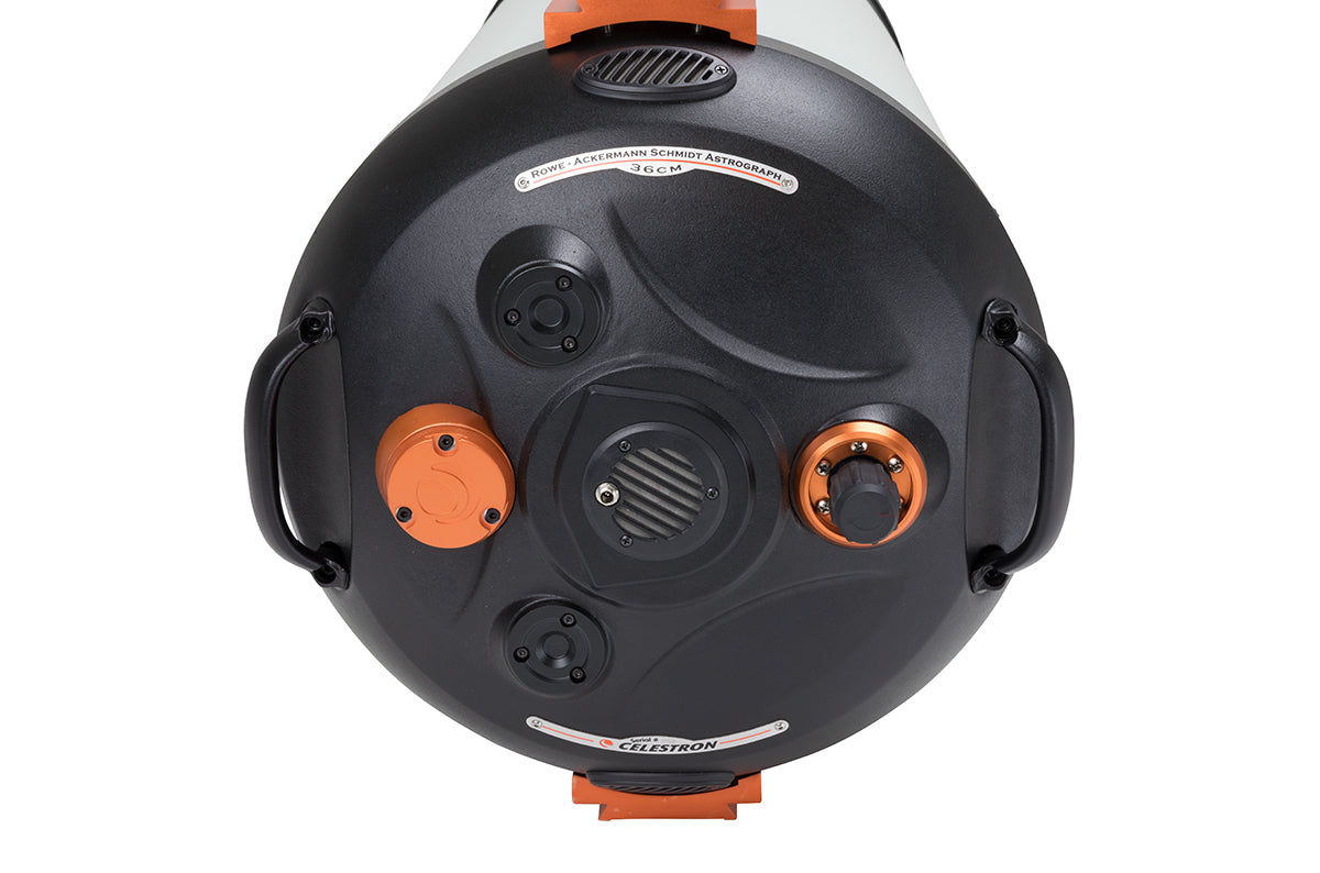

RASA 36 V1’s back features orange mirror lock cap, different focuser base secured with 6 screws and a curved base around the fan. V2’s focuser base has only 3 screws and a flat fan base:
V1
36 cm Rowe-Ackermann Schmidt Astrograph (RASA 36) Optical Tube Assembly (CGE Dovetail)
V2
36 cm Rowe-Ackermann Schmidt Astrograph (RASA 36) V2 Optical Tube Assembly (CGE Dovetail)
