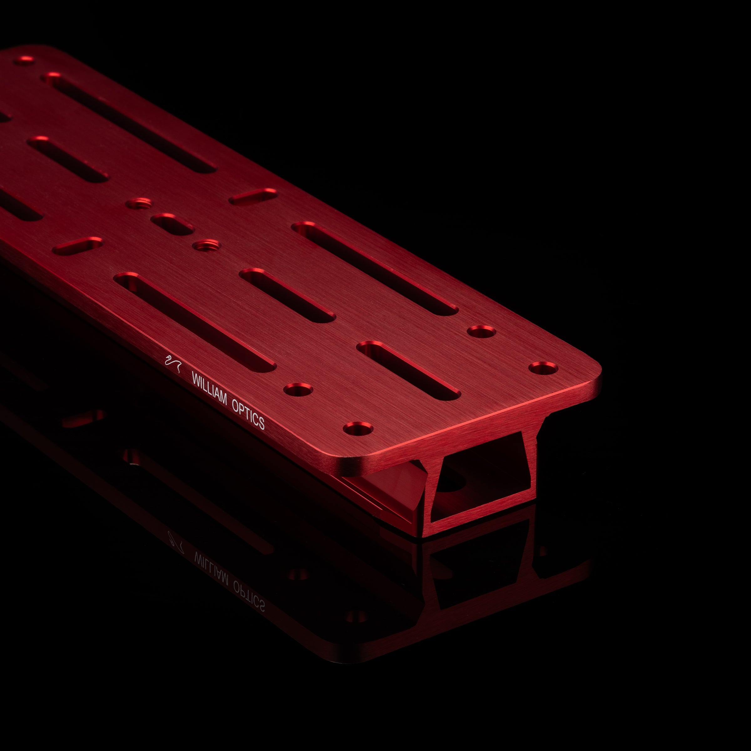

William Optics makes a Vixen style dovetail plate that is 3.5” wide. I think that’s the solution for me. I just need to find riser blocks that will fit, that shouldn't be difficult.
https://williamoptics.com/products/vixen-style-dovetail-plate
Vixen-style Dovetail Plate

Eric Gagne avatar
I also found this ADM V to D converted. Much more expensive than William Optics considering I’d need that plus a Losmandy plate but that gives me more flexibility, I could use any Losmandy plate I want.
https://admaccessories.com/product/v2d-converter-converts-v-series-mounts-to-a-d-series-mount/
