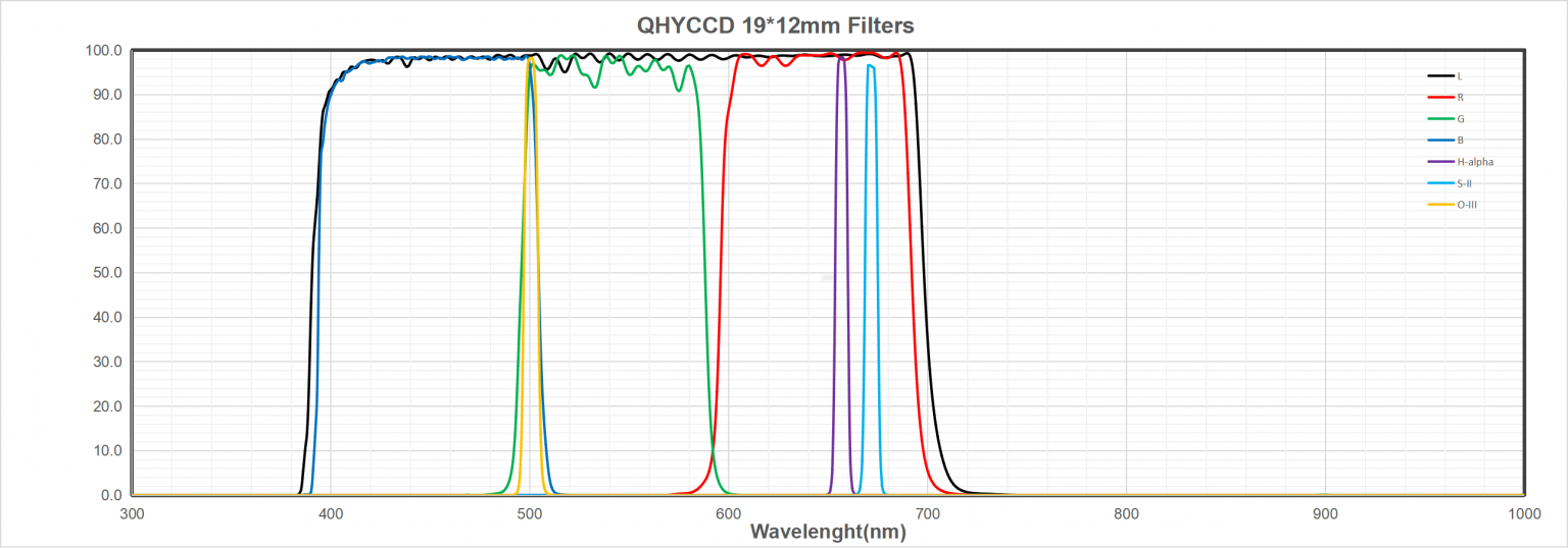

ASI676MC has an UV-IR window. You probably will not see any bloat
I suspect the blue bloat is due to UV sensitivity. The Minicam8 blue filter has good transmission (up to 80%) until 400nm.
It is better to have the UV cut at 400 or 420nm.
On this page Minicam8 seems to have an AR window. Changing it to an UV-IR cut glass will eliminate it.
