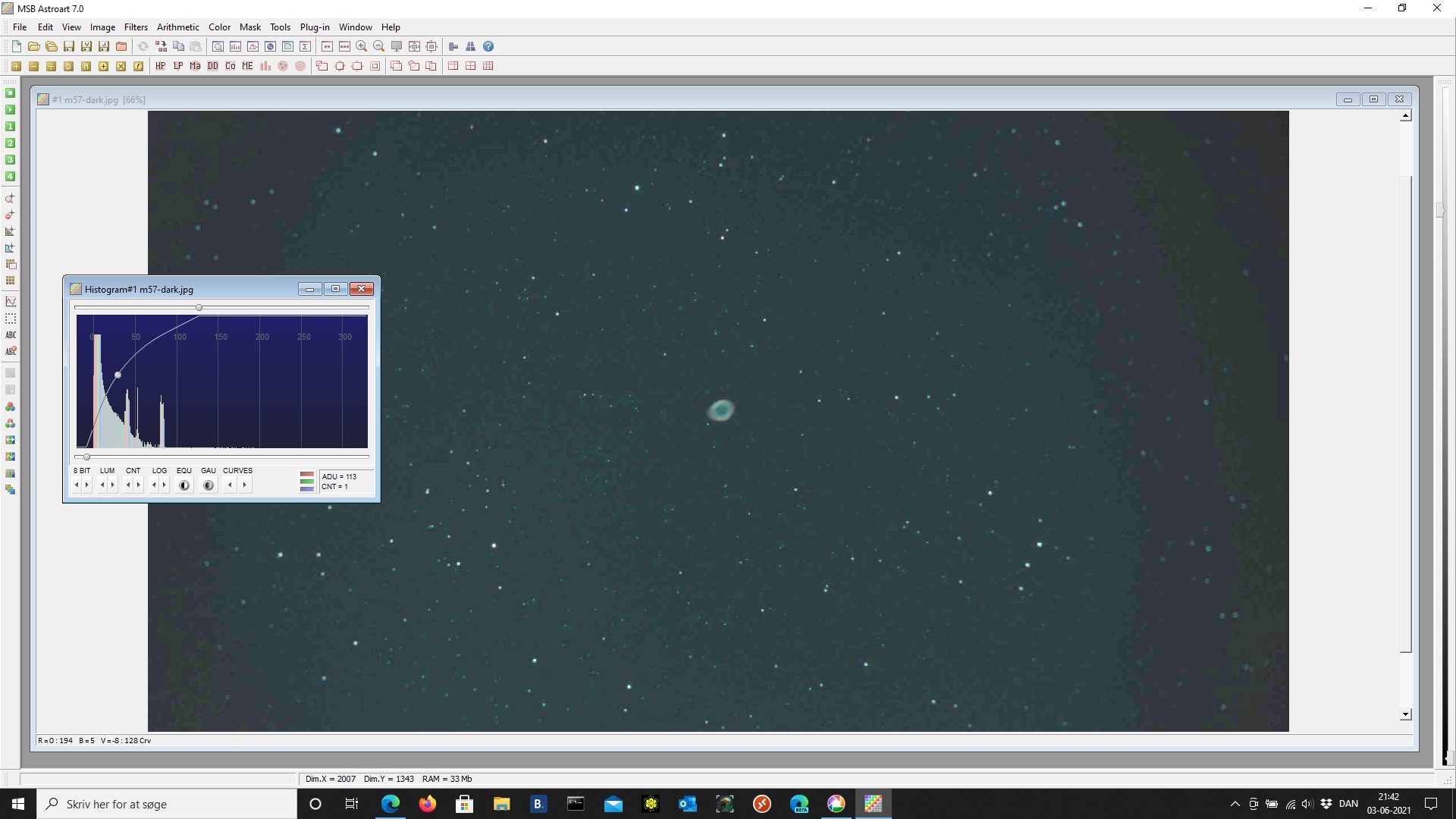

James - I posted the images above (before and after) so you can see what I mean about 'wrecking' the image! It went from a nice black sky with a nebula in it to a bright turquoise field with an over-exposed white blob in it!

Oh goodness… what on earth happened there. A few possibilities come to mind, but if I’m reading correctly you’re seeing this loss converting from 32 bit TIFF to 8 bit TIFF? Maybe it is better to redirect and look at that step. Is there a reason why you are doing this? In Photoshop a proper workflow is to import as 32 bit TIFF, perform any initial “stretching”, and then convert to 16 bit for all the remaining post processing. 8 bit shouldn’t be used for this thing in the Photoshop workspace or as a storage format for your master files; only when exporting to JPG.
Looking at how dark your initial image is, it does look like it should receive the initial manual stretching in Photoshop after being imported as a 32 bit TIFF.

Well, I'm not sure on what you have done between the two M57 images you show above, somehow you have stretched the image.
I do (in PS CS6 menus) 16bit Tiff -> 8bit Tiff -> Save as xx.jpg all the time as the last step in PS CS 6 before I upload my images to Astrobin and/or other places on the internet.
Here I have taken a copy of your  first image (nice black one where the vigneting is hidden) and just stretched it using curves in Astroart.
http://www.dl.dropboxusercontent.com/s/0fm6uiajehfj3lt/M57blackWcurves.jpg?raw=1
Nope. I haven't done any stretching between the two images above. Literally all I did in photoshop was open the TIFF then Image > Mode > 8 bit
